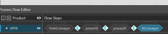

this part is working
The dual Gudel robots have a built-in robot transport controller, so if you switch the robot, you need to change also the transport links to use the new robot’s transport controller.
Also generally, if there’s two robot transport controllers doing transport on a common source-destination sequence, you need to build transport links for both of them. The flow will then look like this, when 2 different TC:s implement transportation between shared source and destination.
