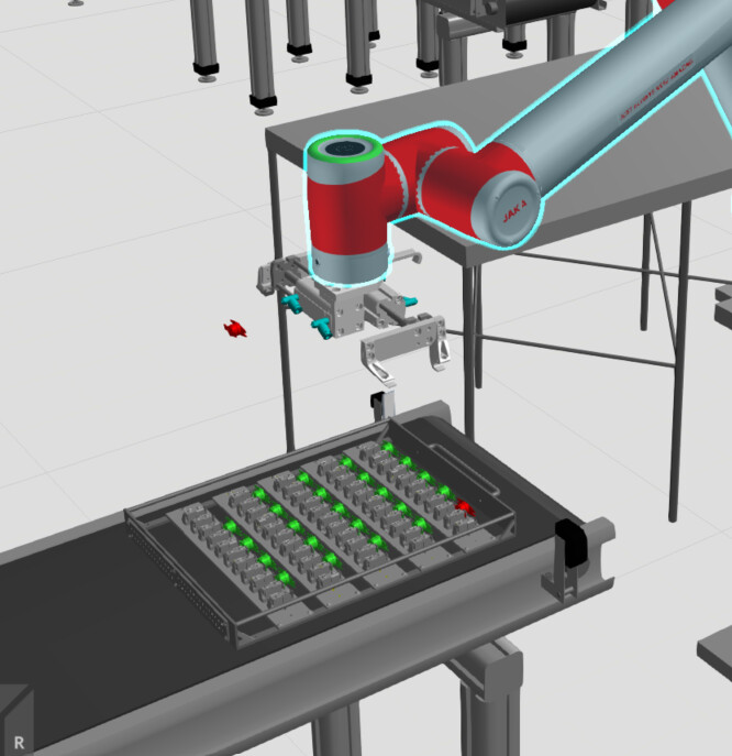

Hi all,

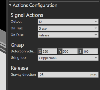

I have modeled the following gripper using the Visual Components tutorials for gripper modeling. However, the gripper does not seem to grip the entire pallet below it—it only detects one component. I have already increased the detection volume to cover the entire pallet in the Signal Actions.

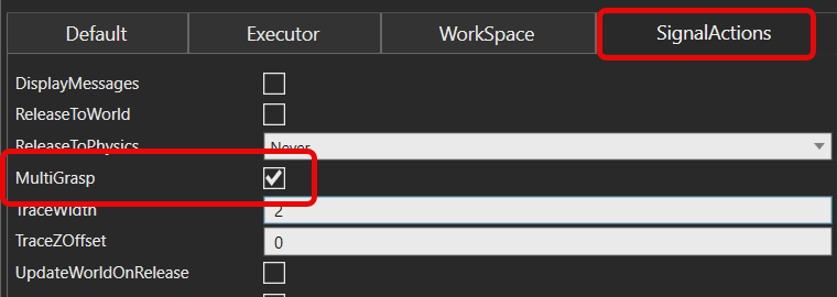

Have you activated the MultiGrasp in the robot properties:
I increased the Detection volume for the gripper and it seems to be working correctly now. Thank you though
