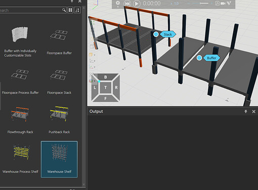

When I try so set the slot count of the flowthrough component in the eCat to 1, the buffer process inside the rack does not work (error attached). Is it a bug or are there any ideas on how to fix it?
It’s a bug in the component. There’s a formula in the component’s script to calculate distance between slots, and it tries to divide by zero when SlotCount is 1.
I would advise to rather use Warehouse Shelf component in this case, and modify some of the properties so that it looks appropriate. Flowthrough Rack is a special warehouse shelf, as it has the additional third dimension (depth) for products.
Thanks for the reply! For now then I will use the warehouse shelf item :slight_smile:
