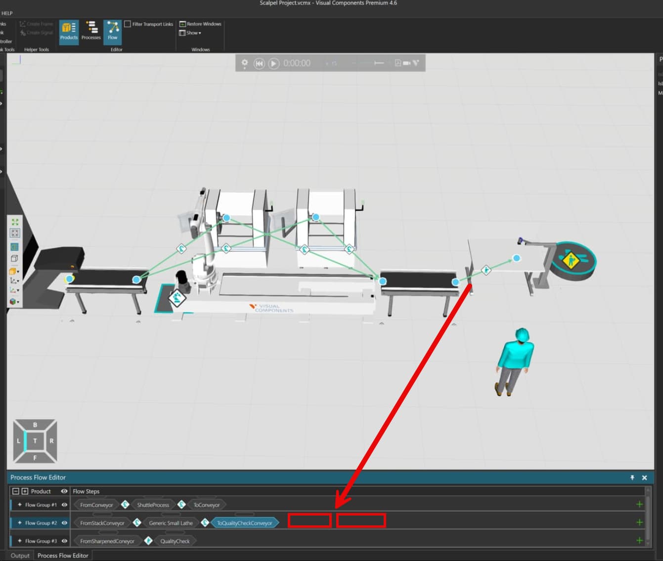

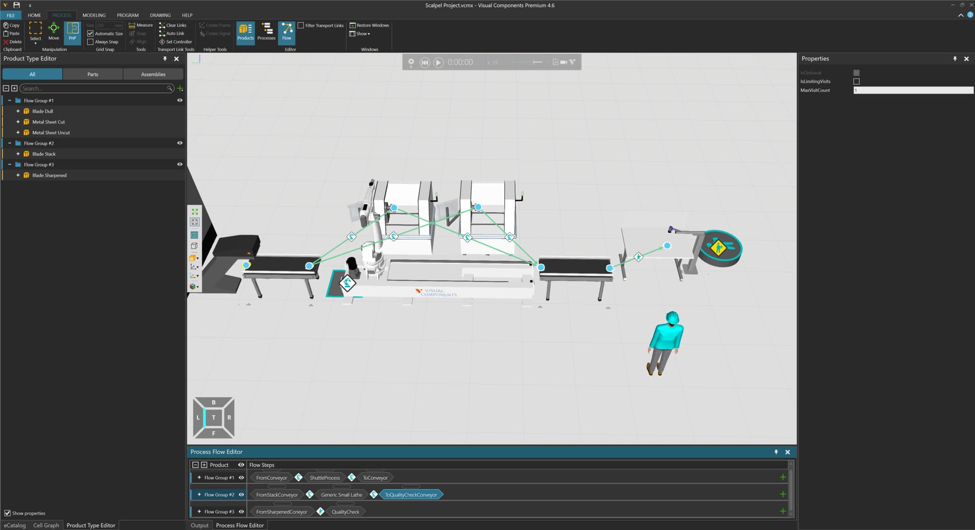

Thank you for the reply, I dont know if i should open another question for this, but whatever I try to pick up from the end of the conveyor, even the standards feeder cylinder, outputs me the error: From Conveyor Process #3::ProcessExecutor__HIDE__::FromConveyor::Transport Out error: Product’s Blade Stack state within its flow sequence is lost.
It looks like there are some steps missing in you Process Flow Editor:
Thank you, I thought they had to be in a separate flow group and I made Flow Group 3! When I tried to connect them in group 2 I still received errors
