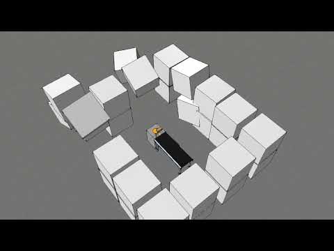

I’m bewildered by this issue I’m having. As you can see clearly in the video attached, the moment my feeder creates an item with joints , the joints seem to spawn outside the feeder and rush towards it toppling everything in its path. Is there a way to avoid that?
Looks like there is extreme strain (forces) on the joint, causing it to “explode” before settling.
Generally such strain could be due to overlapping colliders (which you might be able to avoid), or incorrect initialization of the physics bodies (which you might not be able to do anything about).
So try to check your colliders and that physics entity mass and physics joint parameters have sane values.
This is a bug, so unfortunately you cannot avoid it. Please submit a bug report to support channel.
The issue is that the feeder creates some parts of the component at the origin. The joints then pull the blocks into valid configuration, causing these excess forces and explosions. Below is a frame right before the explosion:
