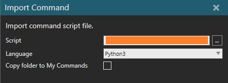

Alternatively, install the addon by drag-and-drop. This way you can use an addon without restarting the software.
Python 2.7 addons have a init.py file. It is responsible of adding the command’s icon to the user interface of VC. Drag and drop the init.py to the 3D world.
Python 3 addons require that the main addon file starts with “cmd”, but init.py is not required. Drag and drop the main addon file to the 3D world.
Remember to select Python 2 or Python 3 from dropdown. In 5.0 it defaults to Python 3. Installing Python 2 addon as Python 3 does not work.
Picture 1: Installation options when addon is drag-and-dropped to application.
