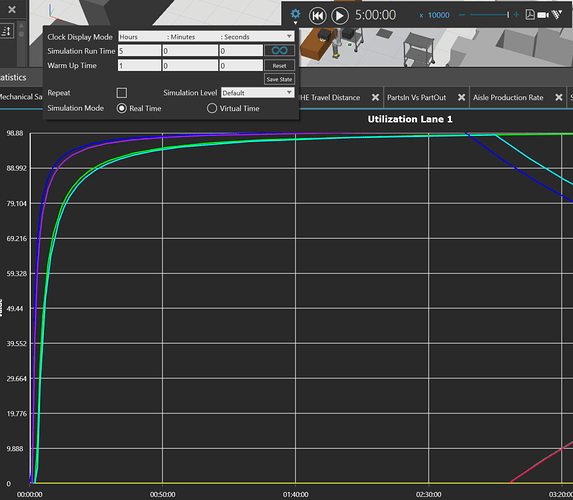

is there any way to exclude warmup time in the statistics and report results?

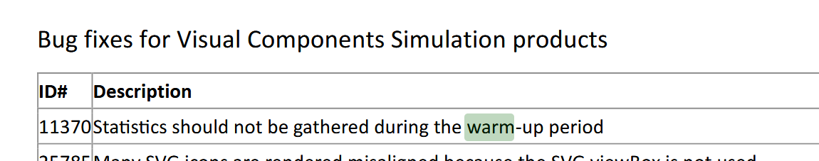

hi,
Statistics are now no longer collected during the warm-up phase
in 4.10 release notes:

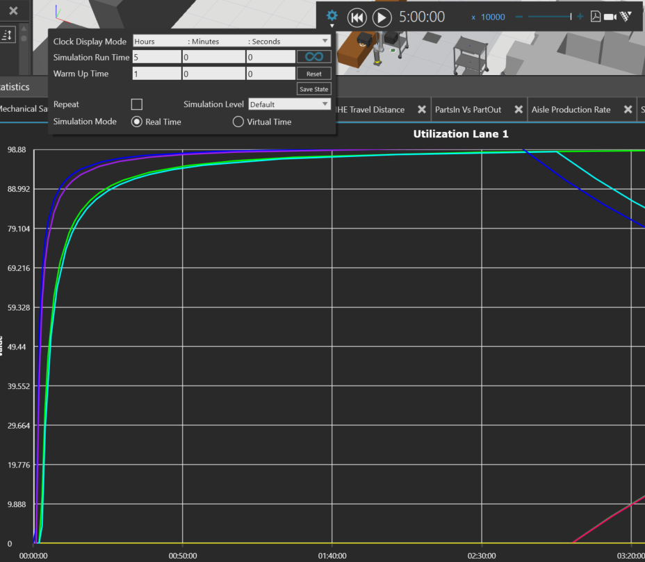

But if warm-up is exclude, how come the data is still shown in the statistic chart (here the property is Statistics.Utilization)?

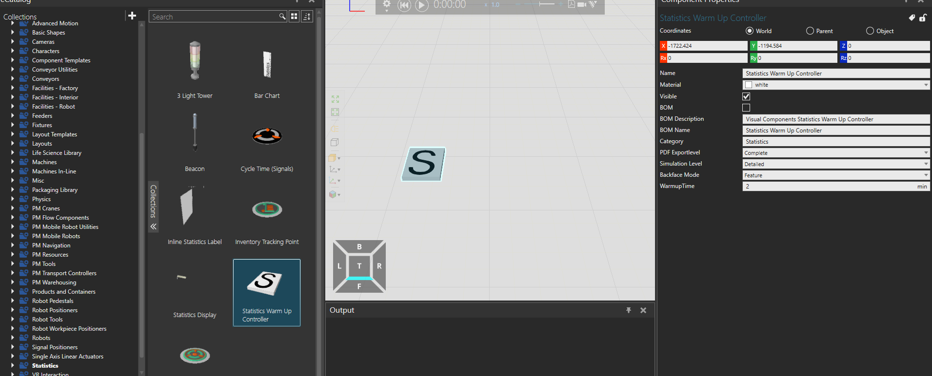

you may need this component
