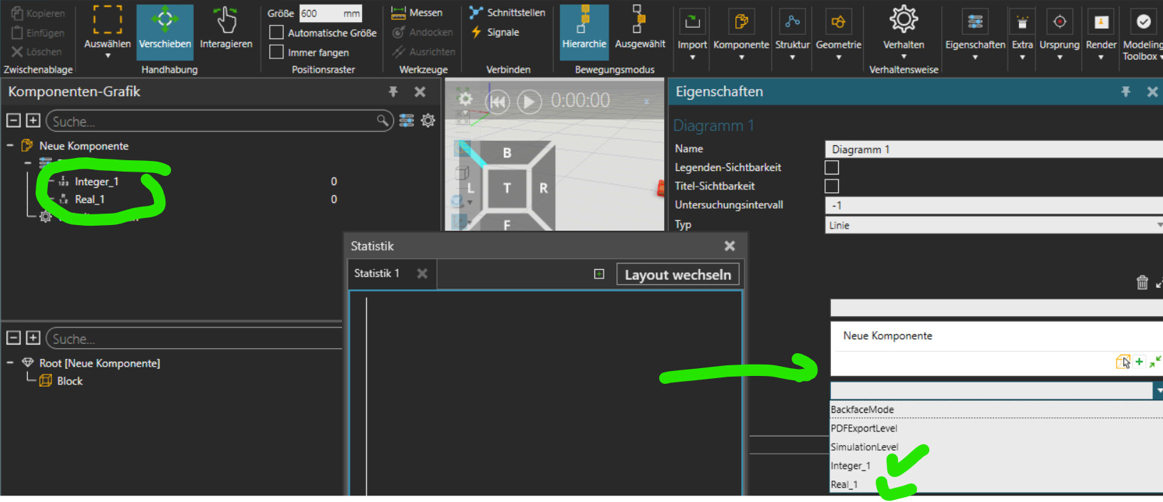

have you created routine properties?
you should create component properties, you can choose these props in statistics:

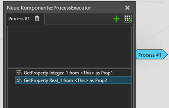

in process routine use GetPropertyStatements:

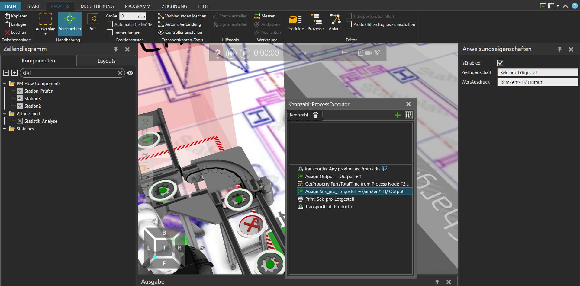

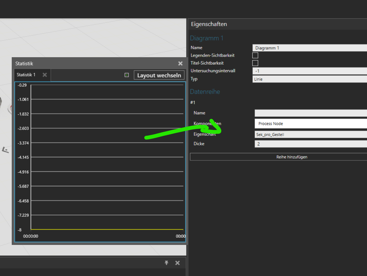

Looks good, thank you.

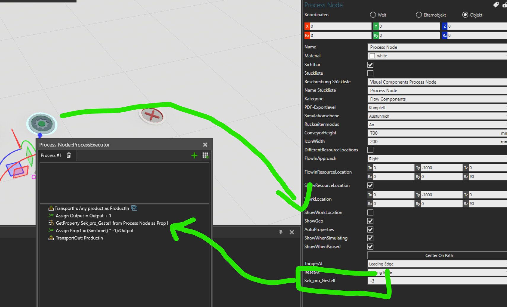

But how can I set the value of the variable “Integer_1” in “neue Komponente” (in your example) to the value of a variable which is part of a process node?
The problem is that I have the variable in the process node (marked in the picture) and I want to display the value of this variable during the simulation time in statistics. So how can I set a random component property to the value of the marked variable?
Also the value of the variable changes so every time a product passes the process node a new calculation will be done an the updated value should be displayed.

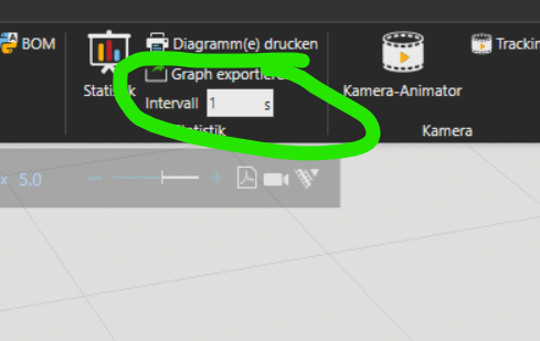

As a note interval is in default 60s:
Great help! I appreciate it
