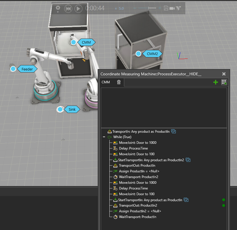

if you want to transport Parts In and Out simultaneously, you can use StartTransportIn-Statement in process routine. More about this in the tutorial:
related to your other question:
an idea as a draft:
the process routine can looks like this:

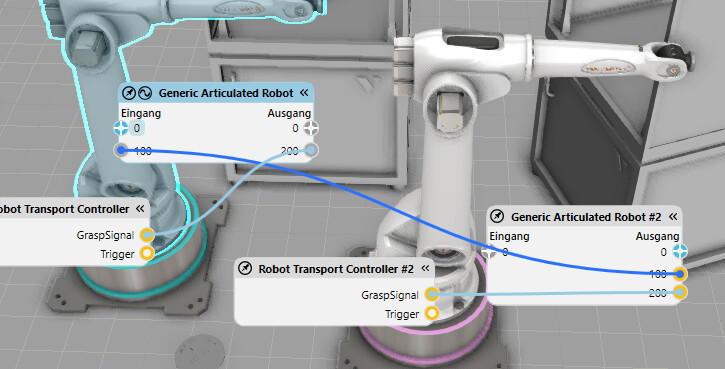

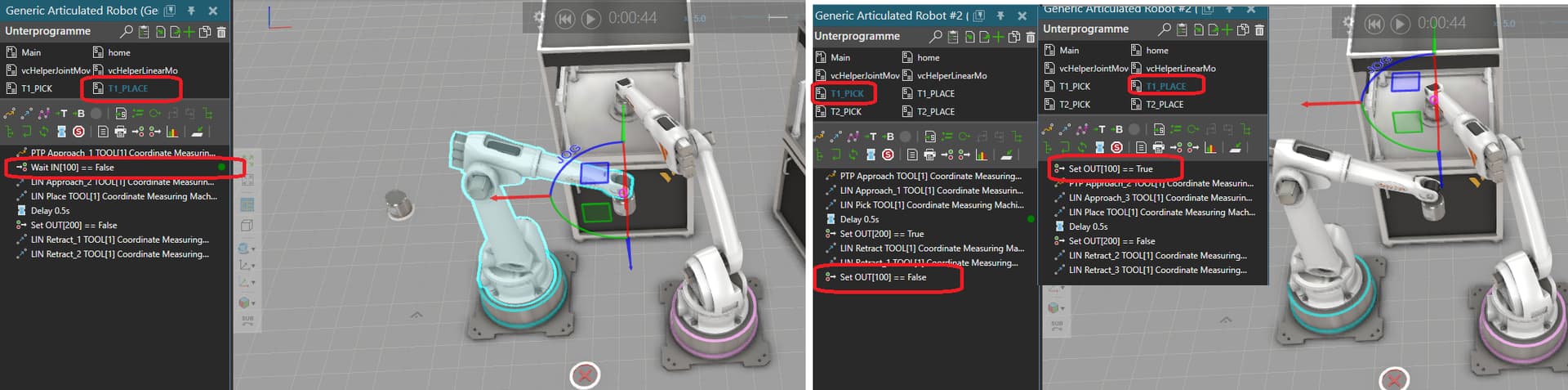

first remove finished part and then place the raw part, you can exchange signals between the robots via the executed robot routine:
attached the example.
TransportingPartsInAndOutSimultaneously.vcmx (533.4 KB)
