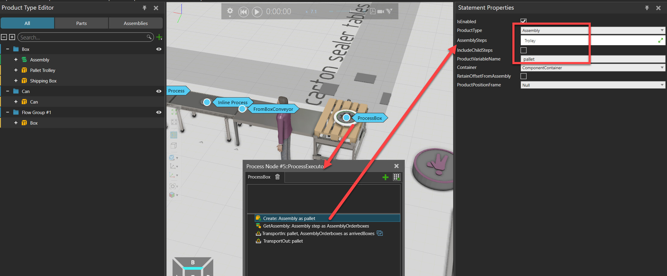

right now in your process, you are using a “TransportIn” for the pallet / first-step-of-the-assembly, but there is nothing set to create or bring a pallet there. So you can either use a feeder or somewhere from which the pallet is coming, or use a Create statement to create the first step of your Assembly there. Once you have the pallet, the worker will be able to put the boxes on it, and the AGV will wait for it to be full before coming to get it:
Hello it works now by creating an assembly instead. Thank you for your help :blush:
