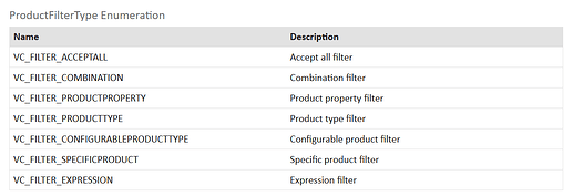

you will need to use the filter constants :
So first you want to set your combination filter with .setFilter :
combiFilter = statement.setFilter(VC_FILTER_COMBINATION)

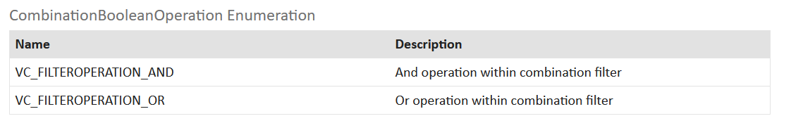

then you can insert filters in this filter using these combination operation constants:
with .insertFilter( index, filterType, operation) :
productFilter = combiFilter.insertFilter(-1,VC_FILTER_CONFIGURABLEPRODUCTTYPE, VC_FILTEROPERATION_AND)
propertyFilter = combiFilter.insertFilter(-1,VC_FILTER_PRODUCTPROPERTY, VC_FILTEROPERATION_OR)
