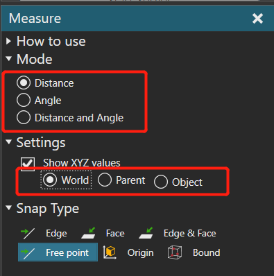

When designing a Python Add-on, how do I create a click-through property like the Measure menu option, as shown in the following figure?

With Python you can add properties to a command that are supported and those are mostly the same as for a component e.g. VC_STRING (str) , VC_BOOLEAN (bool), VC_INTEGER (int) etc.
Only the properties of a command are shown in the action panel which in turn means that the drop-down (expandable) sections are not supported nor the radio buttons.
It should be possible with .NET only.

Ok, thank you.
