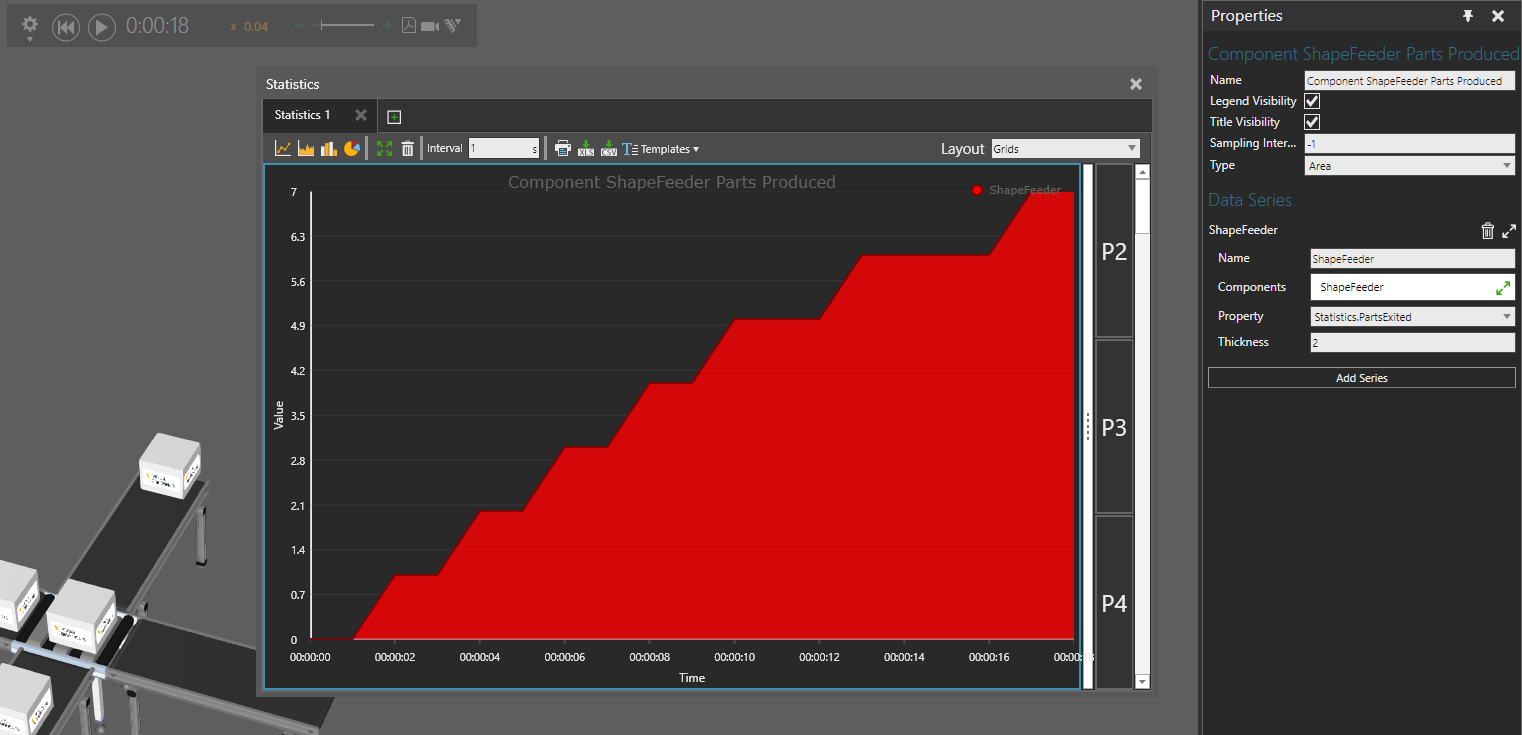

I would like to know how we can count the objectives (boxes, skillets, packages, etc), which components do I need to add? and what should I change in the program?
The boxes are coming out from the shape feeder.
You can use statistics. For example, you can create a chart that reports how many parts go in and out of the feeder.
Looks like the shape feeder does not have a Statistics behavior, so you would need to either add it and assign it to OutPath behavior of the feeder (see attachment) or use a conveyor that is fed the parts and track how many parts enter the conveyor.
