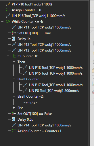

Im making a logic program with the robot, the trouble that im having is with the if condition. I firstly assing the “Counter“ variable to 0 so it can start from 0, but in the simulation he jumps to the “Counter = 1“ and does another thing, i mean he doesn’t enter the “Counter = 0“ he literally jumps to the next one. Here the program:
Thanks in advance!
Counter=0 might be treated as assignment of zero to Counter, not comparison to 0.
Should be Counter == 0
