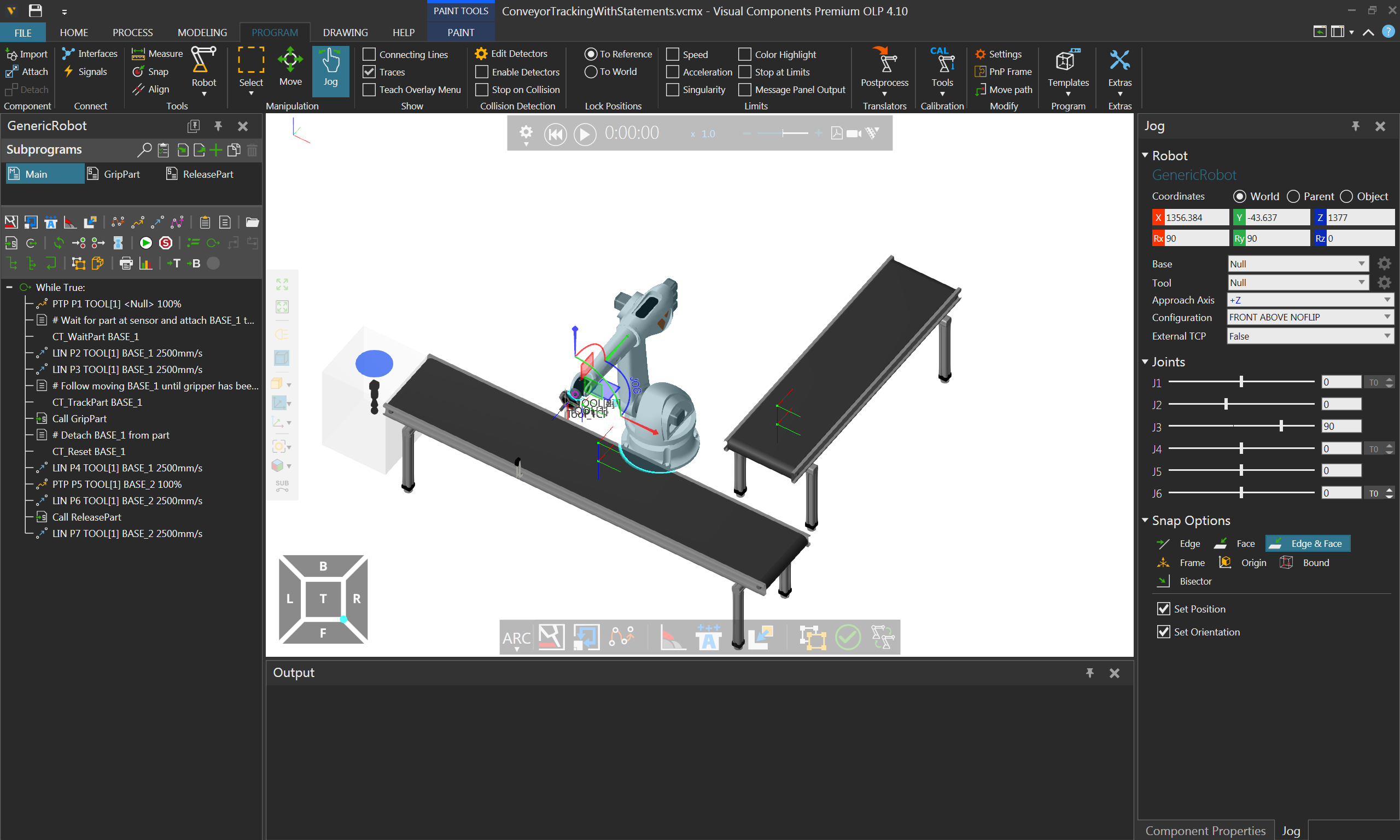

I use Visual Components Premium OLP 4.8. The trace case runs normally, but can’t see three new statements on program tab,cause unusable.

Can you tell how it fails? Screenshot or layout file would make it easier to debug it. I just tested the example model and it works. I can also delete statements and python scripts and use it again successfully.

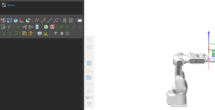

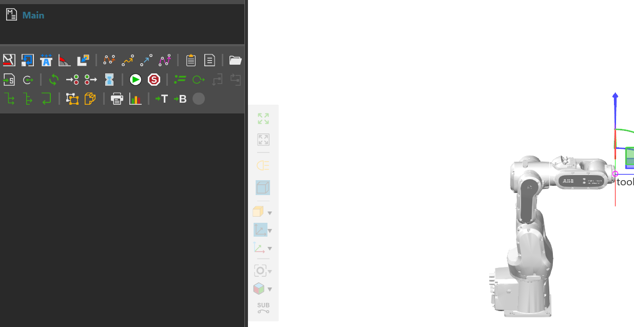

There is no icon for the plugin in the robot program interface
You seem to be using OLP product. In OLP product editor is not customizable with python API. I modified the add-on at the original post attachment so that with OLP product buttons are created at the ribbon instead. Please download that updated version and try it out.

I have re-downloaded the plugin (ConveyorTracking_25112024) from the article and placed it in Python 2, but I still haven’t found the ribbon you mentioned
Thank you for pointing out where the functional area is. Thank you
