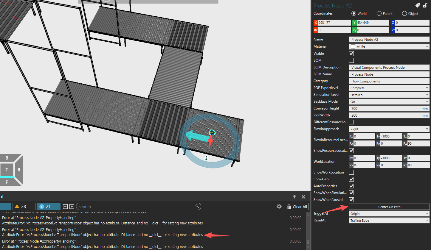

visual components 5.0 .There’s a bug in the conveyor line; an error occurs when I click Center on Path.
That bug was fixed to the process node’s script in 13.3. For some reason your eCatalog shows still the old unupdated version of the process node.
Refresh the eCatalog, wait a few minutes, and verify that the modification date for Process Node is 13.3.2026. That version no longer throws the error from Center On Path. Then replace the process node with the new one.

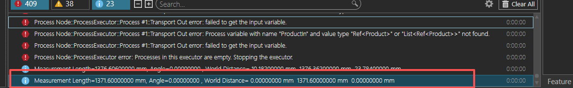

thank you ,Also, for future version updates, I suggest changing the output panel to be the same as in version 4.X, so that data can be directly selected and copied with the mouse.

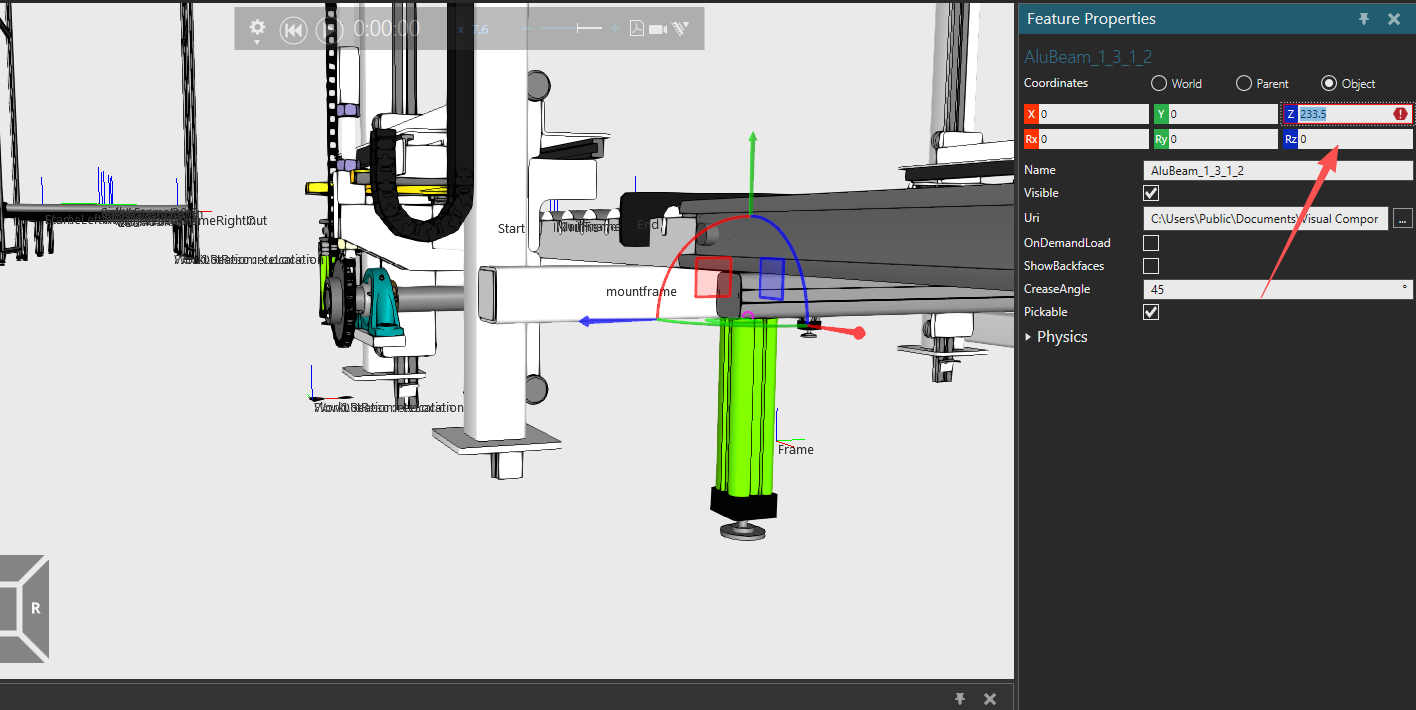

Also, for this field, the function is unavailable when I paste data copied from elsewhere.
