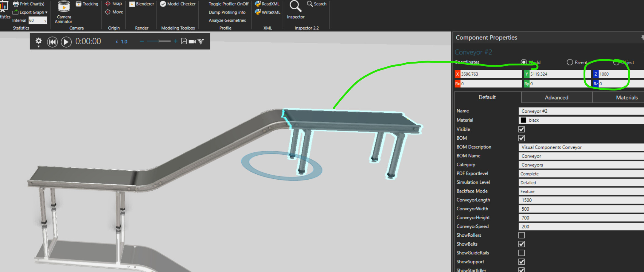

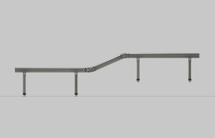

Can someone tell me what I am doing wrong with the VC incline/decline conveyor. When ever I use this conveyor, the next conveyor I place after it, the legs are never the correct length. If I start at 24” elevation, and make the incline conveyor go up 12”, then add another conveyor. I get this:

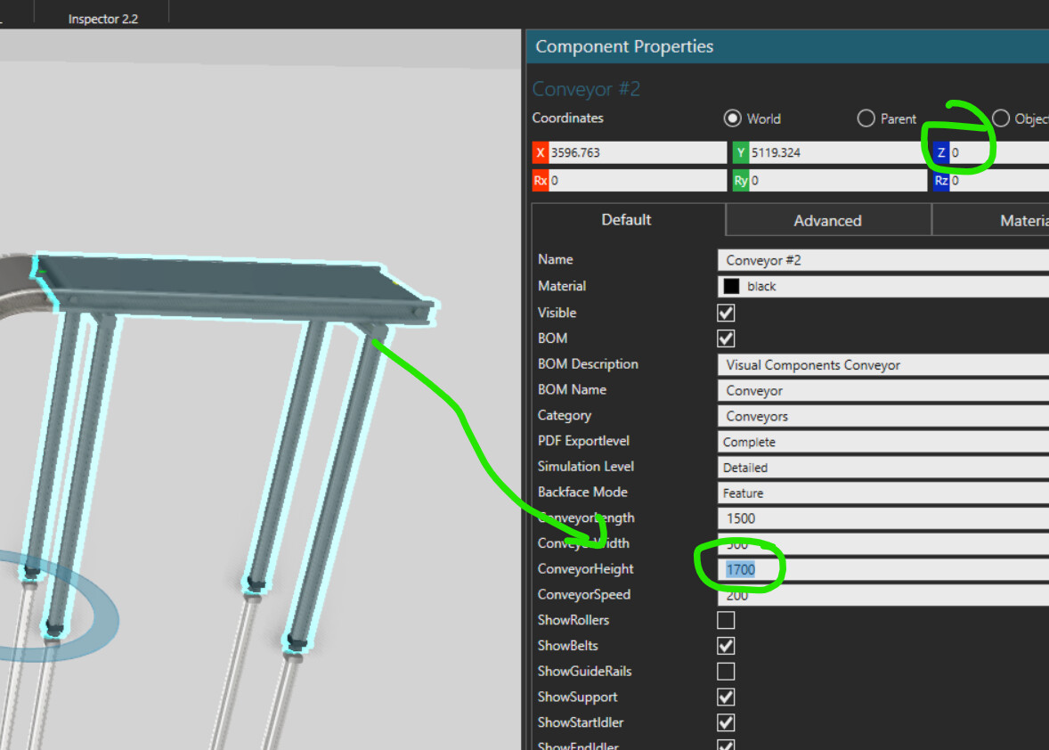

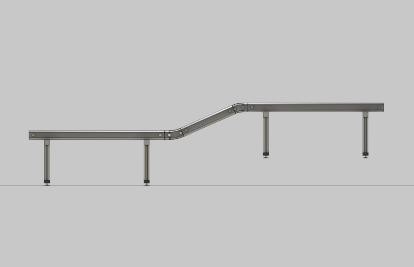

set the Z offset back to 0 mm and add the height difference to ConveyorHeight prop.
I thought I had tried every combination of that, but perhaps I did not. Thanks very much.
