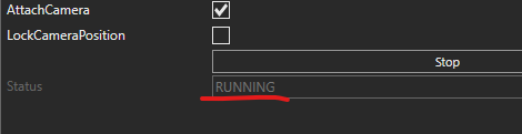

Does this support VC 4.8? The camera does not track moving components anymore.
Yes it works in 4.8 too. Make sure that the status is RUNNING
