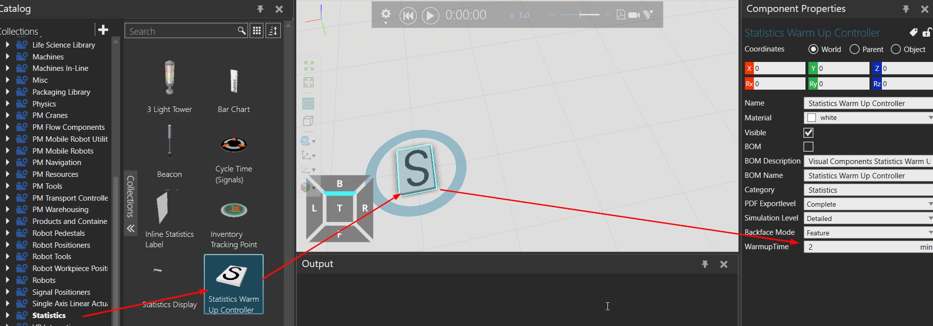

I suspect you have the Statistics Warm Up Controller in your layout.
This component resets all statistics at a set time. The default is 2 minutes. The problem should go away after you delete this component, or change the WarmupTime to something more suitable.
Spot on! I remember adding it to the layout thinking it was necessary for warmup. Thank you!
