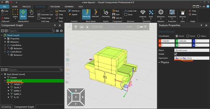

How can I change the flow of this Shrink Tunnel?
Now it’s left to right, and I want it right to left.
I think the easiest way is to change or delete the frames and create new conveyor behaviors with the wizard.
You could also rotate the geometry:
