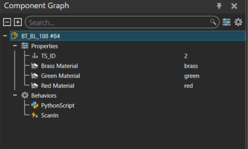

How would the python script for part look look if I wanted the material of a part to change colour to either green or red once a HMI Button is pressed. The original colour would be brass and each part as a property has the ID 1 (for green) or 2 (for red), which has to be manually inputted before the simulation and changes to the corresponding colour once the button is pressed.
This is how my python scripts look for the part looks (currently trying for one part). the part is brass when the simulation starts but stays brass when the button is pressed:
Part:
image501×301 25.7 KB

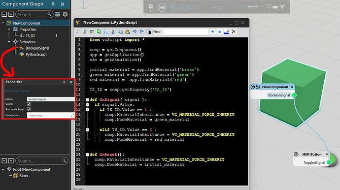

It would be better to use OnSignal to trigger the script when the signal changes.
Don’t forget to add the connection between the Signal and the PythonScript (see the screenshot)
