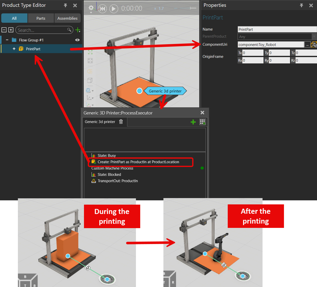

I have saw that the 3d printer can print actual things, but the thing is that he only prints a cube of diferent colors. How could change the model?
Thanks in advance!
Thanks in advance!
The 3d printer has a process with a “Create” statement refering to a product from the Product Type Editor. So you can choose another product or geometry to be printed.
During the printing process, it will look like a cube, but at the end it’s the correct product which will come out of the 3D-printer.
