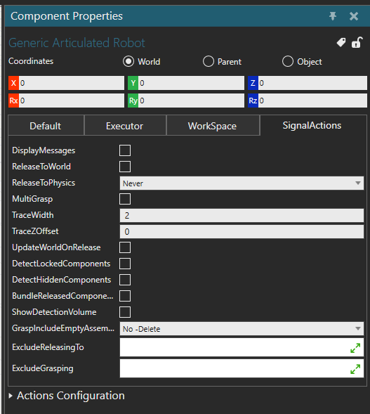

Is a there a function somewhere where you can either choose what material its allowed to Grasp in the Visual components software or exclude components from being able to be Grasped?

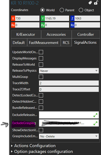

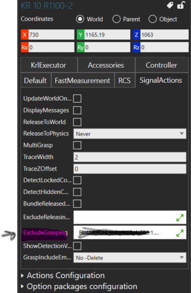

  • Sim
Add components that you don’t want to be grasped to ExcludeGrasping list

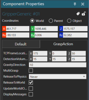

Oh Thank you. Its because i had made my own generic “grasp detection” boxes. Because im using a double gripper… - Therefore i need 2 of these.
I cant seem to find it as a behavior or tool to add to my home made Grasp boxes… Is it possible to use this from SignalActions in 2 places like on a double gripper?

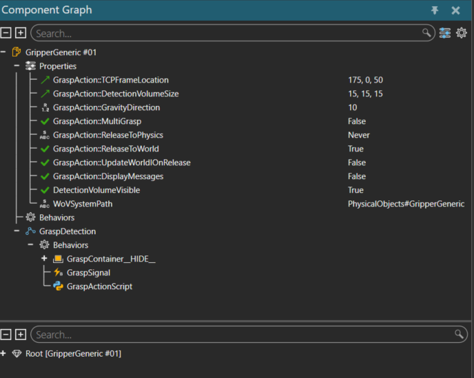

I Thought i made it work using this option - but i realize it had something to do with the generic grasp´s detection Volume.
Is there a way to integrate this option - this "ExcludeGrasping that is build into every robots SignalActions.
Into the Grasp wizard? or manually add it to my “generic gripper” via modeling?
Most of the time, this should be solved by modify each tool’s detection volume, if not, you could try to connect a robot signal to a gripper boolean signal, write a script, before robot pick something, robot triggers signal to gripper, then modify robot’s ExcludeGrasping list.
