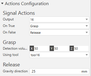

The actual grasping is different from the tool’s gripper closing.
Robots can grasp/lift up components even without a tool.
If you look at your robot’s component properties, there’s an “Action Configuration” section at the bottom. The output IO 16 is by default the Grasp action. So in your program if you set the output 16 to True, the robot will grasp whatever component is in the detection volume.
If you still cannot grab anything make sure your detection volume is correct. You can go to the “Signal Actions” in the robot’s Component Properties and set “ShowDetectionVolume” to true to confirm.
