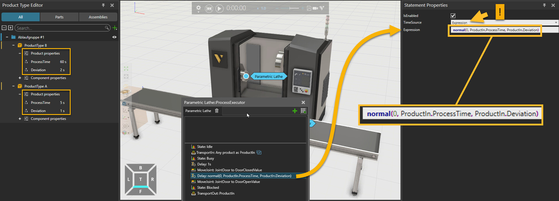

To add producttype specific process times with normal distribution, you can do the following:
  1. Add the product property “ProcessTime” and “Deviation” to your product types
  2. In your process add a delay (if there is not one already)
  3. Set the TimeSource to Expression
  4. Add this as Expression:
    normal(0, ProductIn.ProcessTime, ProductIn.Deviation)

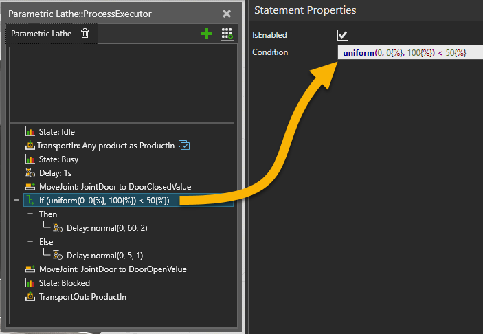

Thank you. Is it possible if there is only product type, 50% process time is normal (60s, 2s); 50% process time is normal (5s, 1s)?
In that case you can use the if statement.
Add two delay statements in Then and Else.
In the condition the uniform function will generate a random number from 0% to 100%.
  • If that number is lower than 50%, the process time is normal(60s, 2s).
  • If that number is higher or equal to 50%, the process time is normal(5s, 1s).

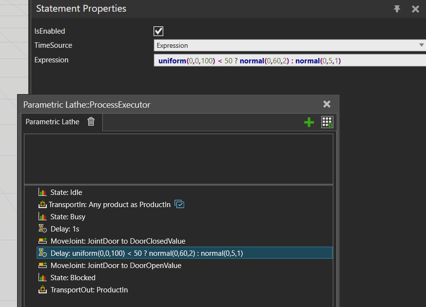

You can also write that in just one line:
uniform(0,0,100) < 50 ? normal(0,60,2) : normal(0,5,1)
