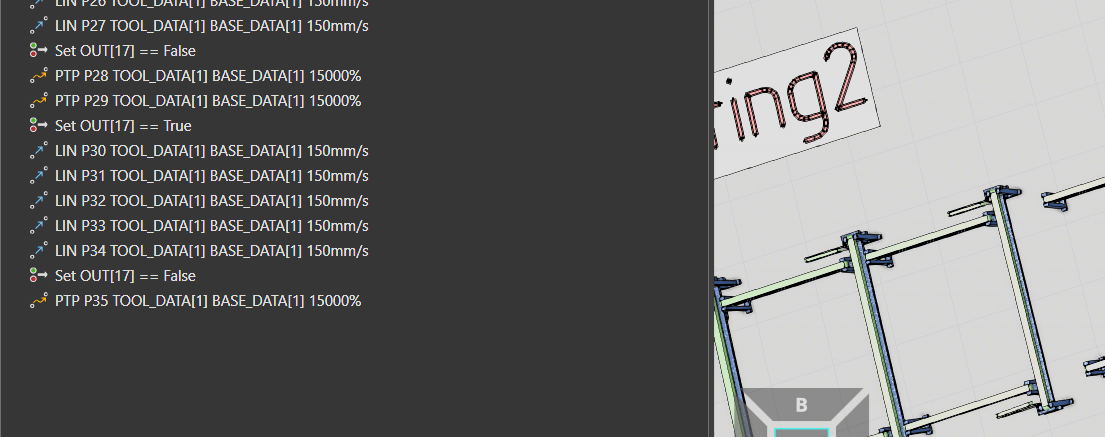

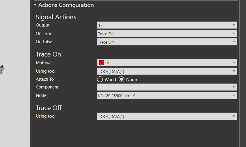

Hej,
If you just want the glue to be displayed in just “line” type.
You can try to use the robots Trace Feature
