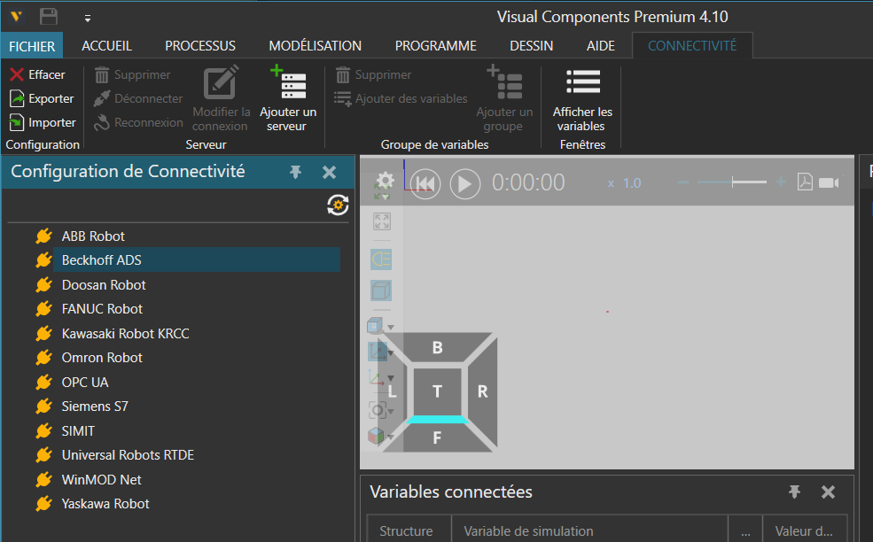

Twincat on and running (TMC and TPY file checked), but still ADS adds server button is missing, and Visual components need some installation.
New 4.9 Premium OLP installation, Windows 11, Twincat 3.1.4026.10 with user UM_RT.

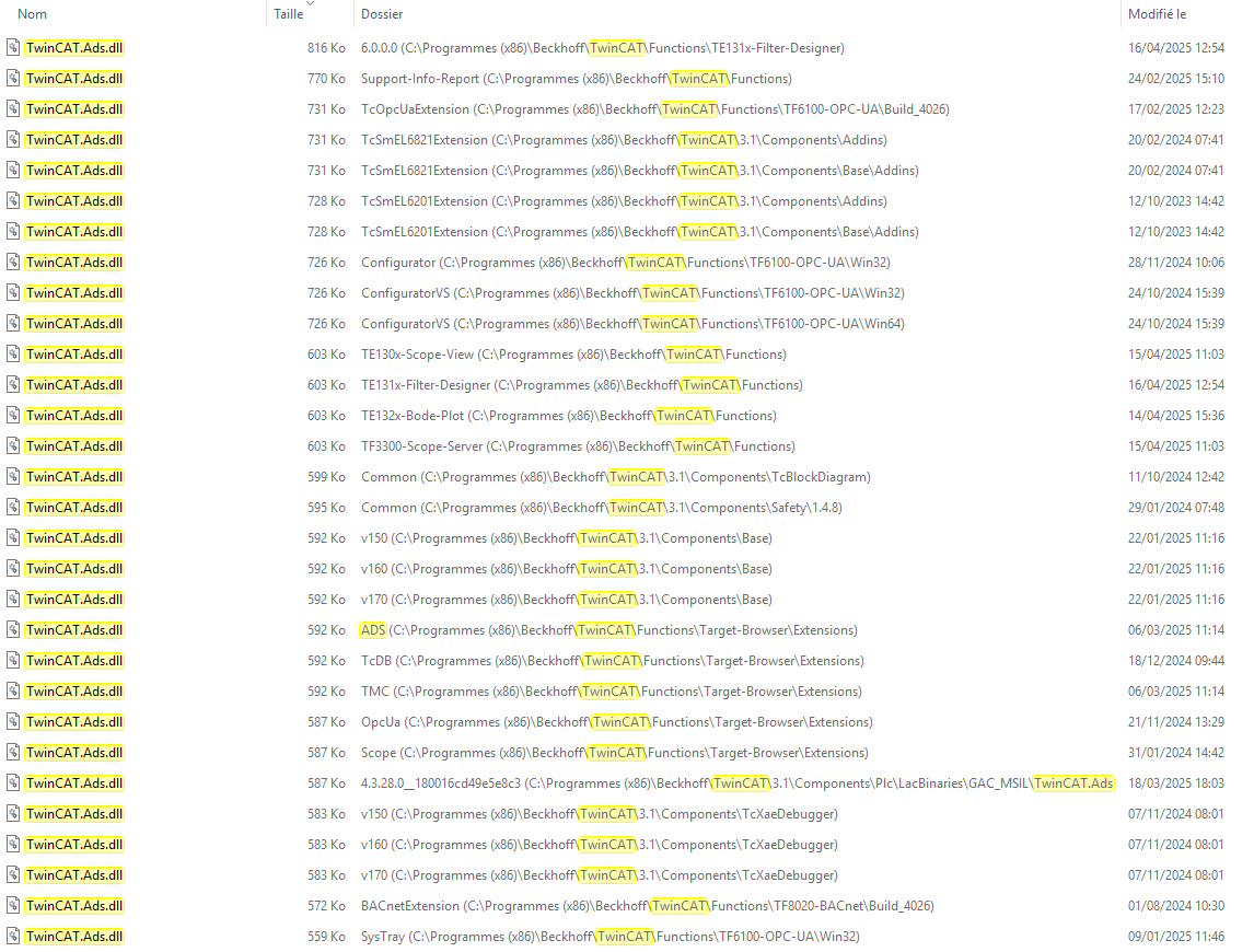

Heum Ok but under the Beckhoff folder installation there are more than 20 files with differents date & size (See image in attachment) ![]()
I’ll test them one by one, I’ll keep you in the loop
Finaly it works.
I created a folder: “.NET” under C:\Program Files (x86)\Beckhoff\TwinCAT\AdsApi\TcAdsDll\
I copied this folder : v4.0_4.3.32.0__180016cd49e5e8c3 located under C:\Windows\Microsoft.NET\assembly\GAC_MSIL\TwinCAT.Ads
under this folder :C:\Program Files (x86)\Beckhoff\TwinCAT\AdsApi\TcAdsDll.NET
Strange but it works ![]()
