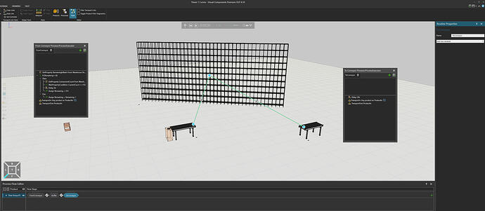

Release products from the warehouse shelf to the conveyor. I have products, say for example 200 in my shelf just i wanted to release them batch wise.
If you already have, lets say 200 products, inside the warehouse shelf component, you can use the “Terminal Process” in the “Flow Components” e-catalog with the Batch configuration or Table configuration for you to use an excel file.
Thesis 1.1.vcmx (253.2 KB) I tried, but nothing is working. If you have just couple of minutes for me.
SC1_Demand_Table_VC_scaled (1).xls (24 KB)
I did it, thank you for the support.
