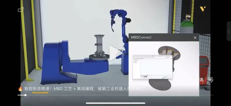

I would like to ask how to automatically generate welding programs using MBD in VC5.0.

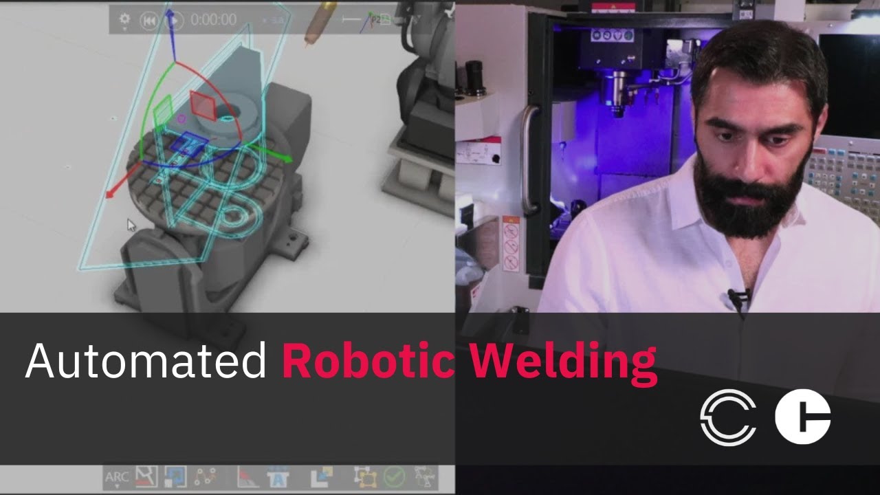

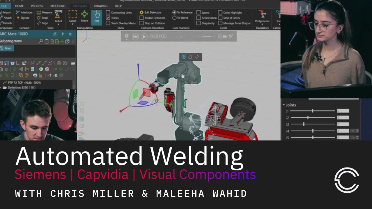

There are also public videos where the complete workflow is explained also with using the MBD software, I can recommend the following videos at least:
I hope these will give you some understanding of the MBD process. We are currently underway of creating example tutorials to our Academy from these topics.
