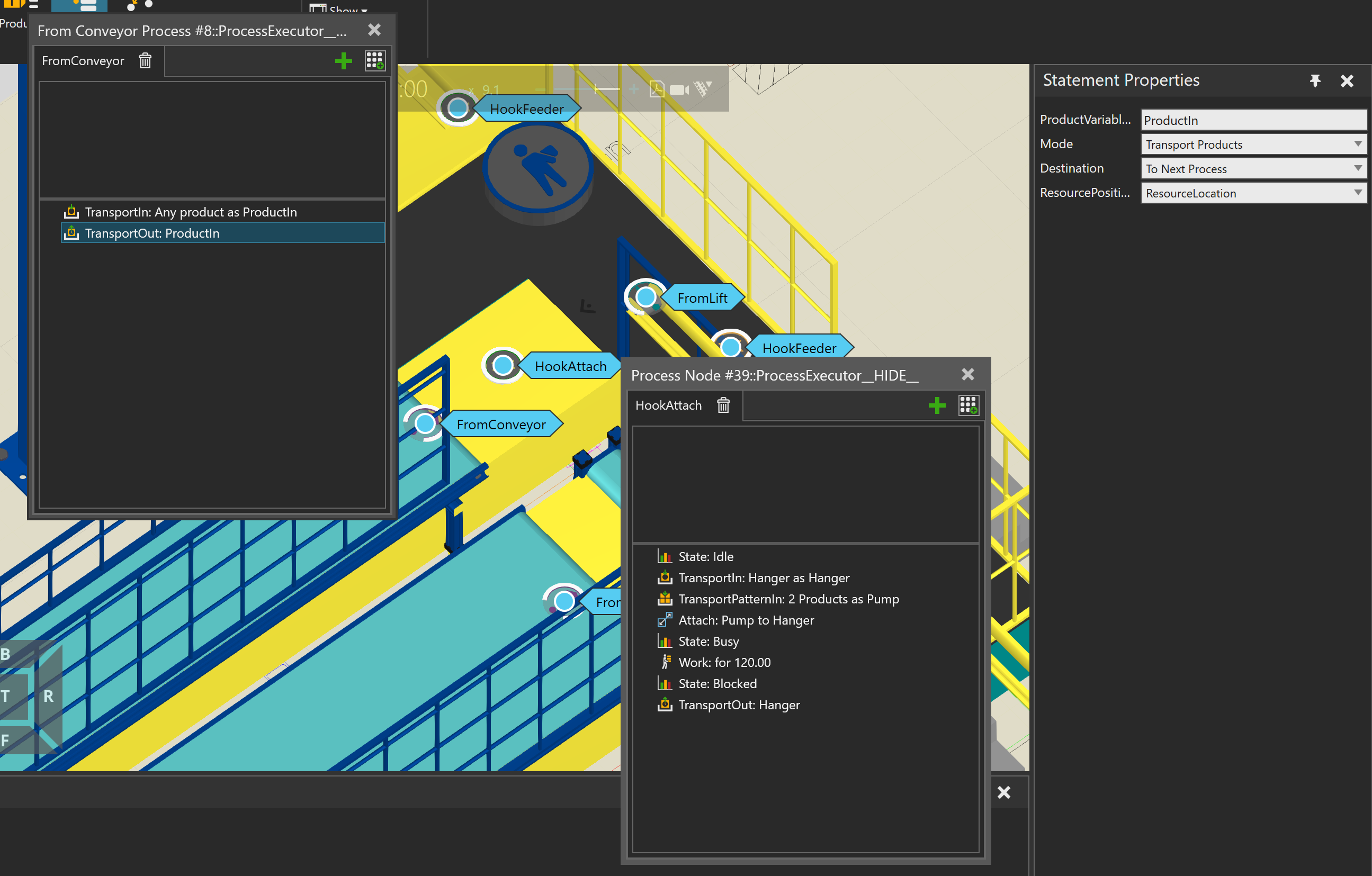

I am experiencing an issue with the transportPatternIn function for two products from the “Fromconveyor.” The products are not moving out as expected, and there are no visible errors.
Could you please assist me in resolving this? Let me know if you need any additional details or logs from my side.

Are the different products in different Flow Groups? If not, it might be best to have the Hanger and the Pump in seperate flows.
It might also be better to add a Product Filter in the TransportIn and the TransportPatternIn, so that the correct products are transported at the correct place.
If that doesn’t work, could you maybe share a screenshot of your Flow?
