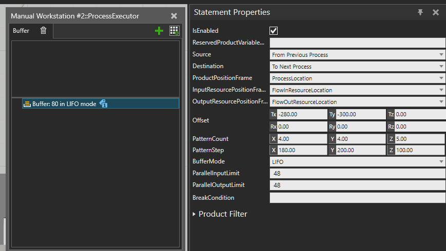

AMR repositioning itself for each pick nad place instead of staying in place
An AMR with an attached robot arm is placing products into a buffer. The issue: the AMR is moving and turning itself before each pick. It should just stay in place and let the robot arm empty its capacity.
What to change?
This is how the Buffer is set up.

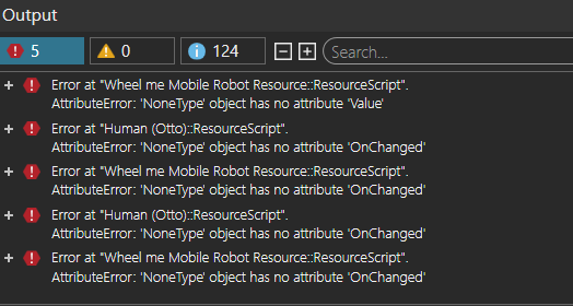

@KustiH AMR resource suddenly stopped working all together after playing with the parameters:

  • The NoneType errors appeared as suddenly the Pathway Area components did not have LimitSpeed and LimitCapacity props any more :person_shrugging: Recreated all of them.
