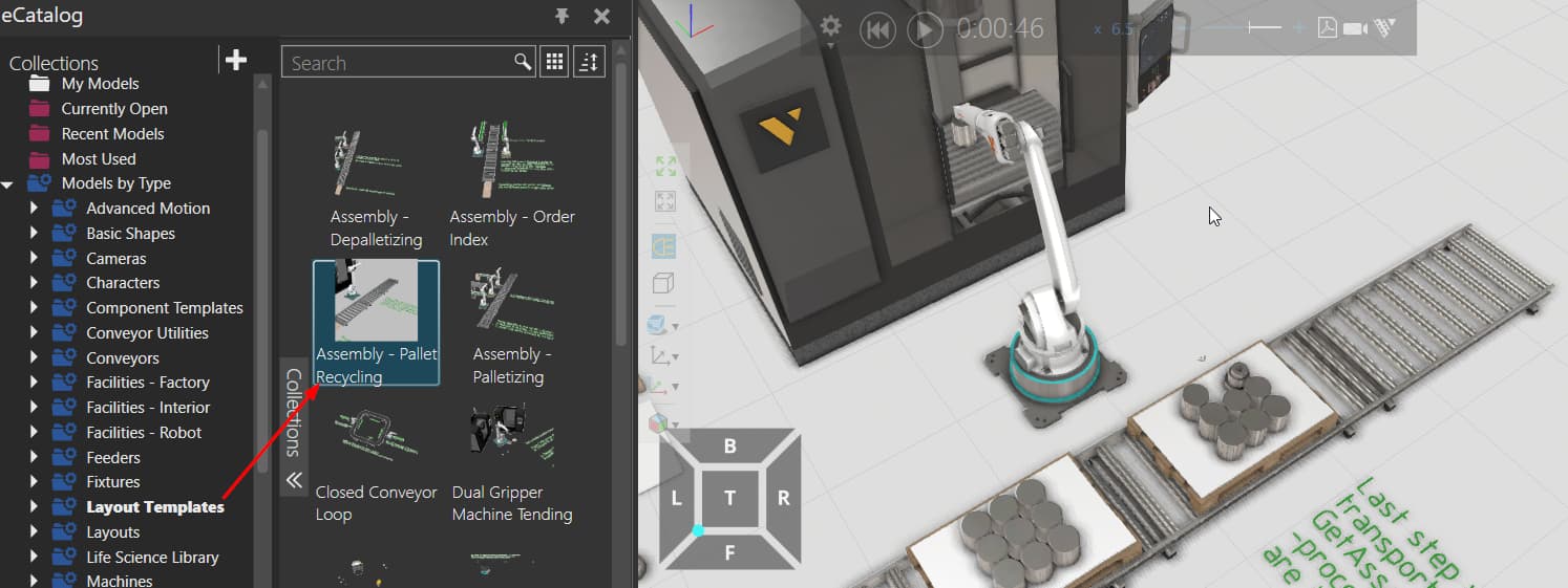

You could create a Process Modelling Assembly that consists of a pallet and 25 parts. Then, create 1 of those from the feeder process.
That seems possible, I am having trouble trying to make it so that components can be picked up one from the pallet assembly one by one by a robotic arm and returned to the pallet once machining is complete any advice?
I think there is a similar layout example already in the eCatalog. Check the Layout Templates folder for Assembly - Pallet Recycling.
You could see how that is done and use it as an example for your project.

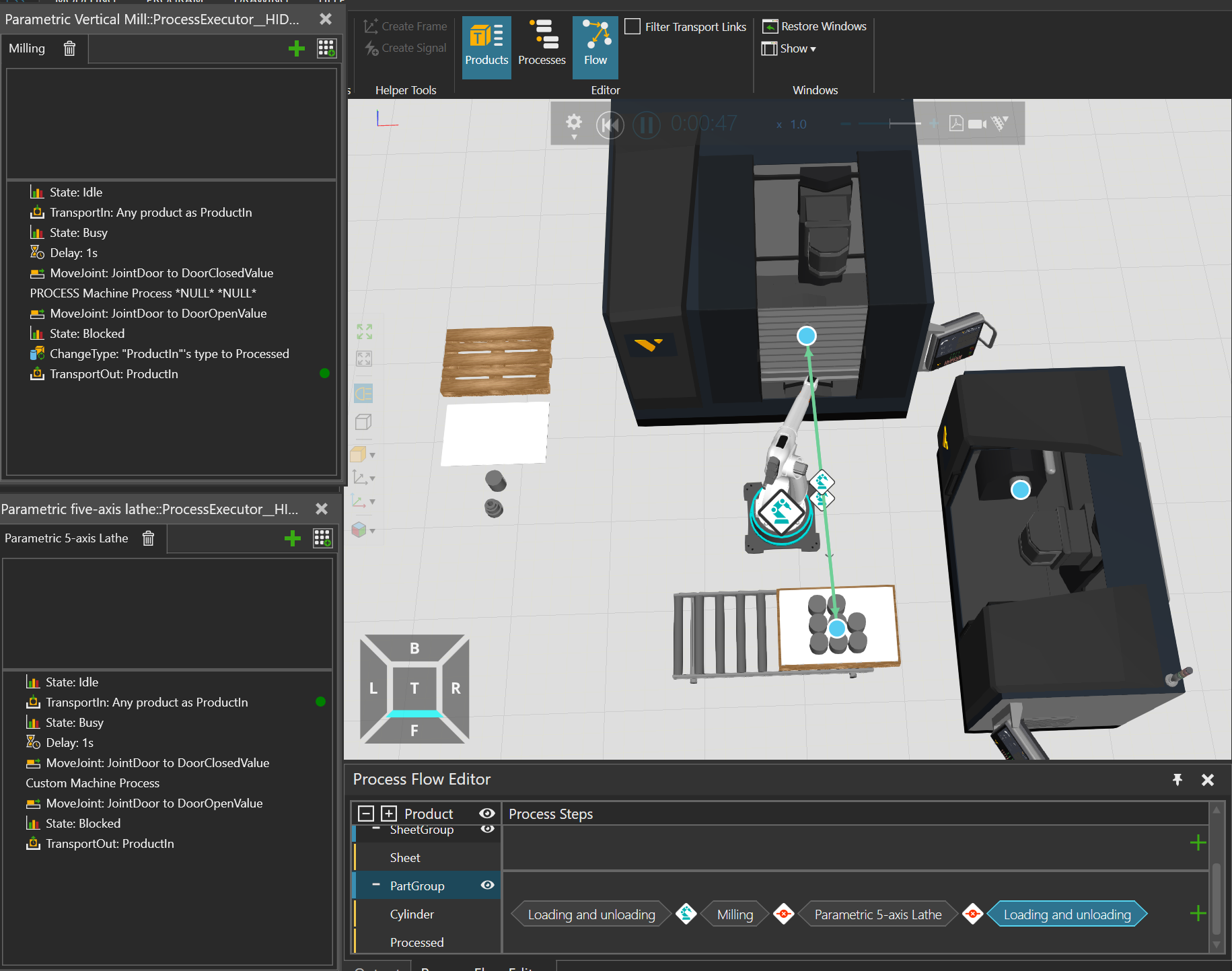

I’ve edited the pallet recycler layout. Trying to get the robot articulator to transfer cylinders from Loading and unloading>>Milling>>Parametric 5-axis Lathe>>Loading and unloading. But robot articulator refuses to interact with anything that is not part of the initial layout. Please help.

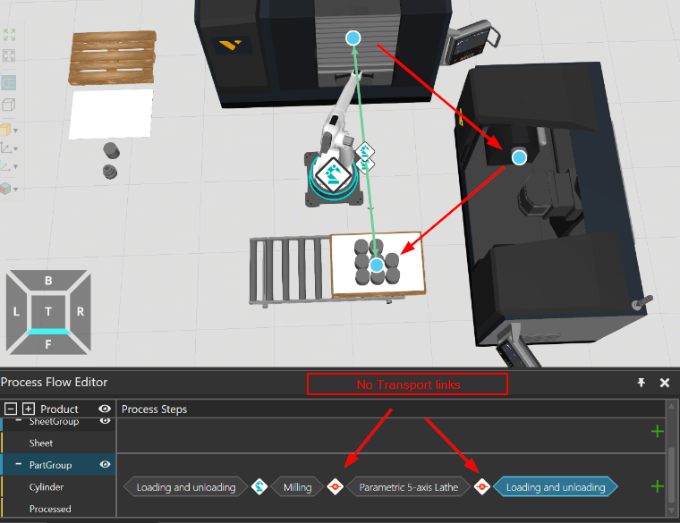

Your flow editor shows with red that there are missing steps between your processes.
You need to add the transport links between Milling- Paramteric Lathe - Loading.
