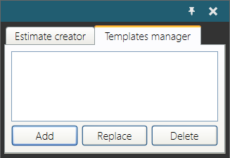

I created a dockable panel with a TabControl inside it.
My problem is that the controls use the Windows styles.
I don’t know if there is a method to use the Visual Components styles or if I have to set them all by myself.
Here are renders of my panel:
Thank you a lot
@Quotechnique Try x:Key="{x:Type controls:XamTabControl}" and more info can be found at this forum thread.
https://forum.visualcomponents.com/forums/topic/adding-branding-styles-and-themes/
I attached development guide as well.
