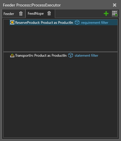

[Process Node Setup]
  • A filter is activated on a ReserveProduct statement.
  • Another filter is activated on a TransportIn statement.

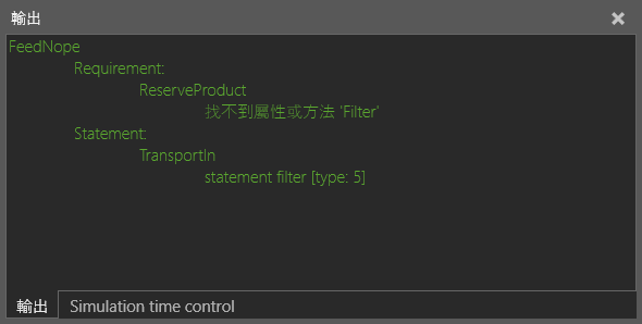

[Output Issue]
  • I cannot retrieve the filter from the ReserveProduct statement. :angry:
  • An error message indicates that there is no such attribute or method available.

          print '\t\t', statement.Type ### "ReserveProduct" on output panel
          print '\t\t\t{} [type: {}]'.format(statement.Filter.Name, statement.Filter.Type) ### error here!!
        except Exception as e:
          print '\t\t\t{}'.format(e) ### "找不到屬性或方法 'Filter'" on output panel

          print '\t\t', statement.Type ### "TransportIn" on output panel
          print '\t\t\t{} [type: {}]'.format(statement.Filter.Name, statement.Filter.Type) ### "statement filter [type: 5]" on output panel
