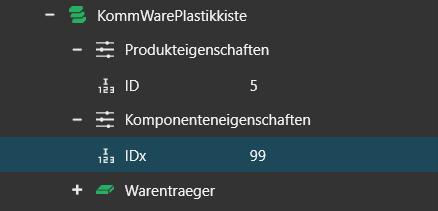

If i use the Process Executor of a Process Node and want to assign a Variable of the Assembly I can do this by: “Assign Variable: ProductIn.MyVariable := 1” for Example.
Like This:
This works but only for the “ID” Variable.
If i try the same for the “IDx” Variable, i do not know how to get access to it.

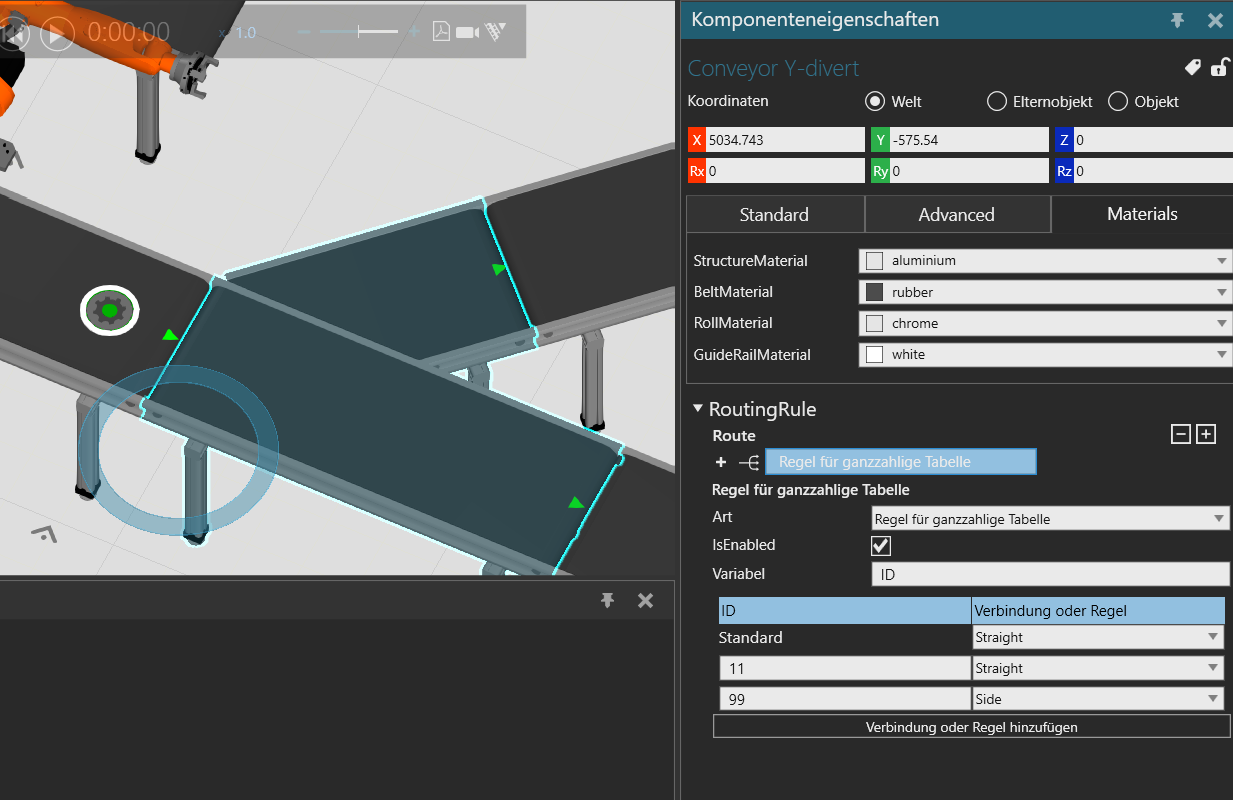

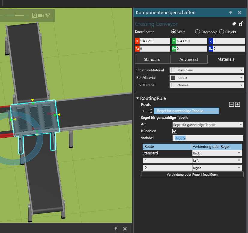

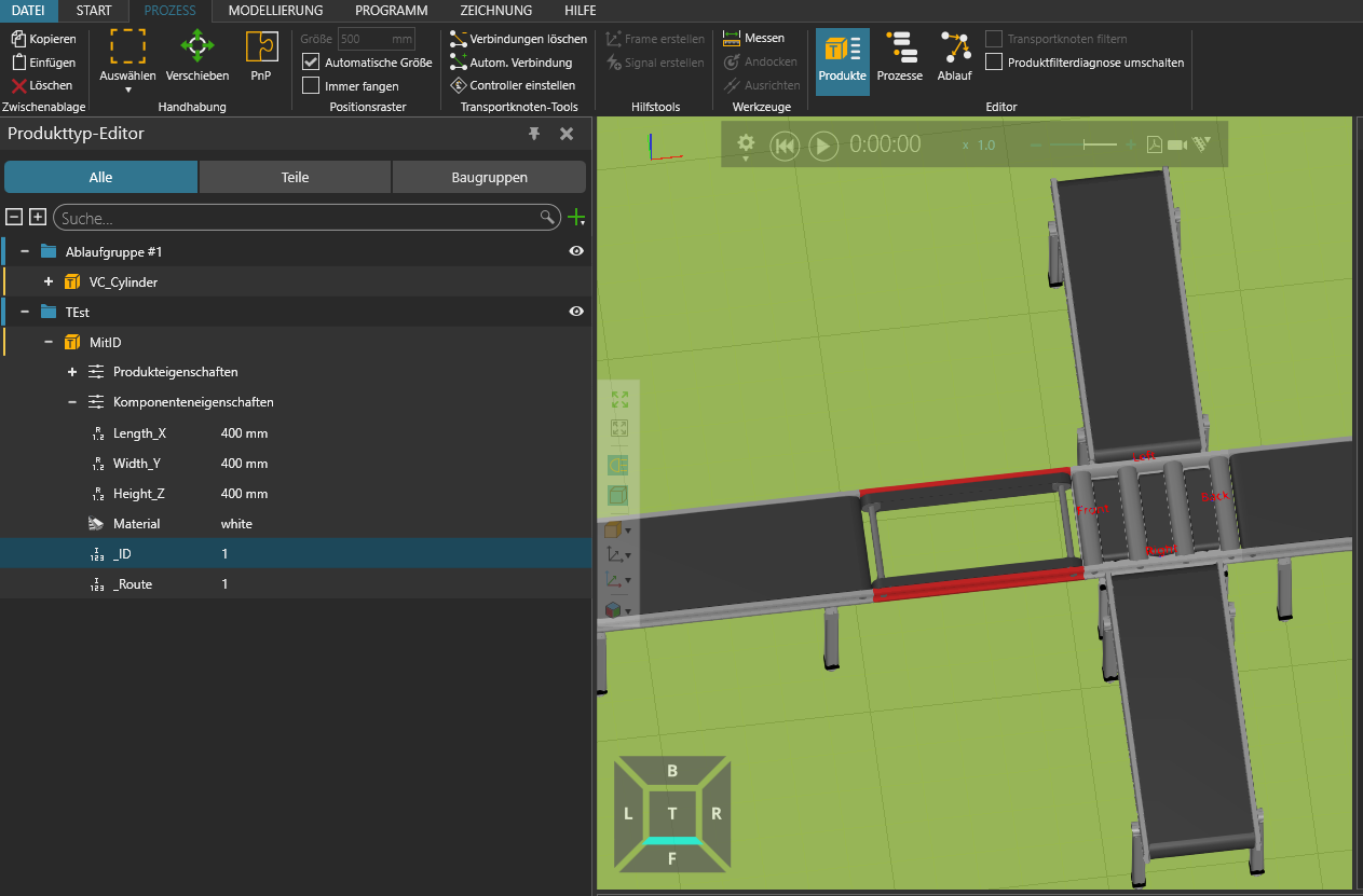

At least i found now a way for me how to handle this topics. First of all, you can add Values to the Component properties (as in Picture e.g. “_ID” or “_Route”).
  • For getting access on this value in a Transfer Conveyor (and this is so much easier than i thought), you simple name the Value of the Procuct in the Routing Rule of the Transfer, that’s it:

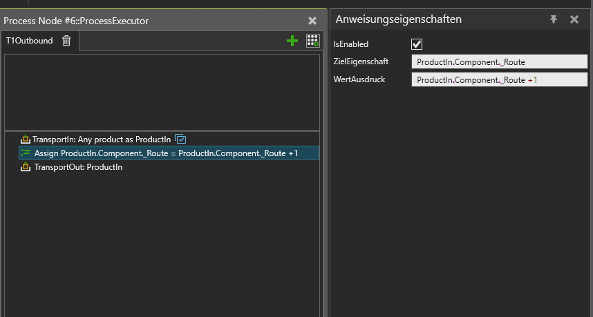

  • For Reading/ writting to this Product Value in the Process Modelling, you can get access on the Value by using the Tree: "ProductIn.Component._Route:
