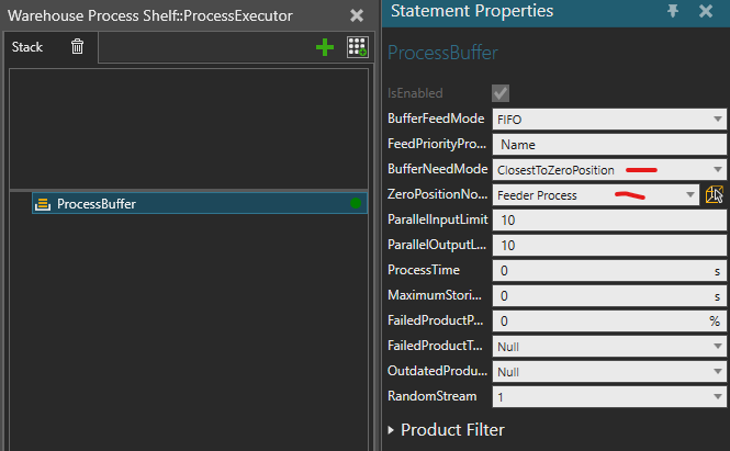

Could you try modifying this setting?

I couldn’t find the ‘Feeder Process’ item under the ZeroPositionNode section.
and I need to BufferNeedMode is LinearOrder.
The feeder process is already there because the component from the 3D world was probably previously picked via this property.
