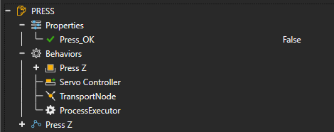

In my case other component name “PRESS” and in Properties “Press_OK = False”
so I wrote "PRESS.Press_OK == False " on the if conditional statement and I got an error.
PRESS Component MODELING
Picker Component ProcessExecutor
Error

However, in your screenshot Press_OK is a component property, not a signal.
Those you can get using the Get property statement.
https://help.visualcomponents.com/4.10/Premium/en/English/Process%20Modeling/Process%20Statements/Get_Property.htm
