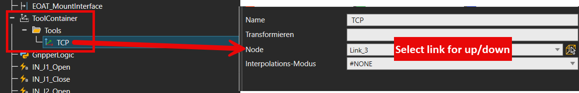

Have you selected the link to follow in the TCP properties?
do you mean i can go to the object which is the ring and add a TCP to follow which would be the link i want?
