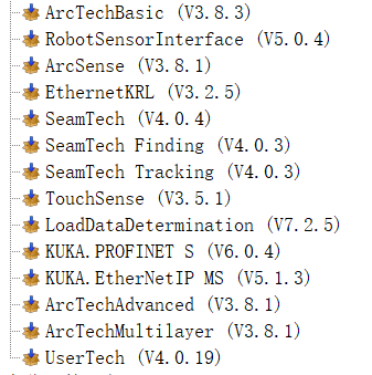

Attached is my KSS 8.7.8 dependency package situation:

I’ve tentatively identified the possible problem point, the weld program exported from officelite uses stArcDat_T in dat, while the weld program exported from VC uses ATBg_Start_T (and I’ve also seen commands that look like ATBg_Weld_T, so they may not correspond here), that’s why I can’t get it to import properly.
I searched Google with the keyword “ATBg_Start_T” and only found one link to a post in another technical forum where this writeup was mentioned, but I couldn’t find a more complete explanation.
This looks like a difference between the old and new dependency packages? This change seems to have occurred during the big version update at 8.5 for Kuka that I know of.
