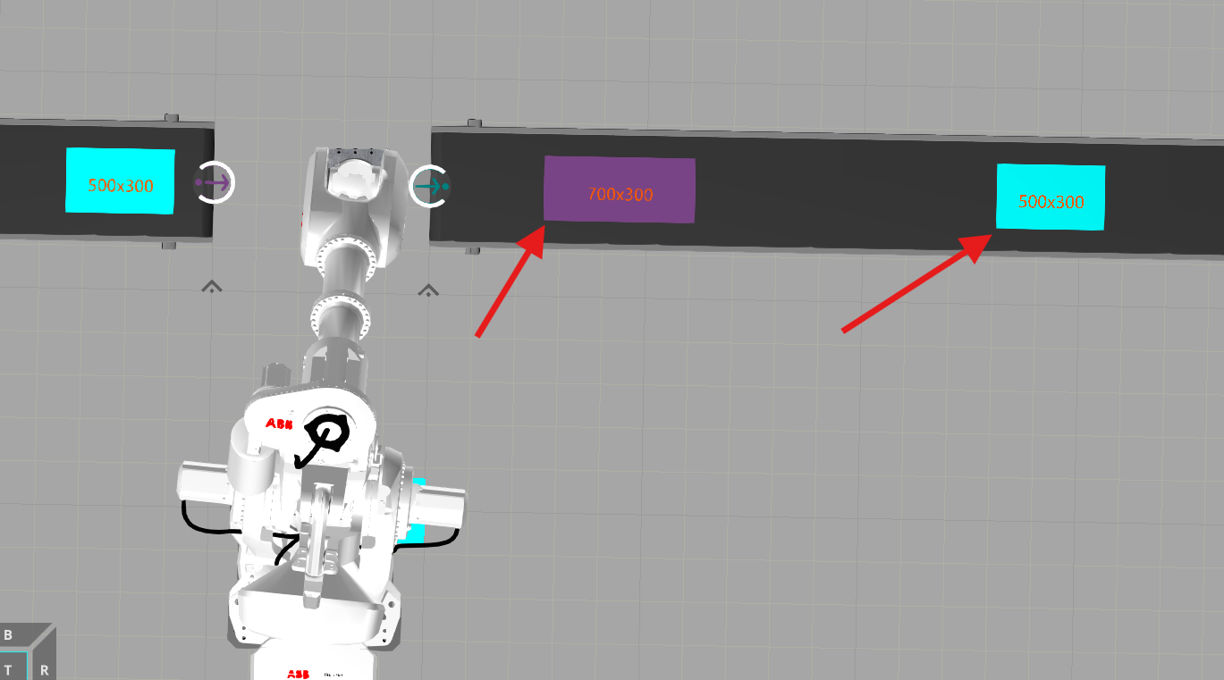

I have this script added in a generic conveyor to listen to events when products are added to the conveyor path:
from vcScript import *
comp = getComponent()
def event_func( container, component, arrive_leave ):
  print("Transition fired, component:", component.Name, "| arrive_leave:", arrive_leave)
def OnRun():
  path = comp.findBehaviour("Path")
  if not path:
    print("Path behaviour not found")
    return
  print("Path behaviour found", path)
  path.OnPhysicalTransition = event_func
Products are added to the conveyor, but the event never fires - why? Thanks!
Since the product comes in from the To Conveyor Process, you should probably use OnTransition event instead. It’s inherited from class vcContainer.
Based on the OnPhysicalTransition event’s description, it triggers at product’s leading edge, which does not hit the path’s start in this layout.
