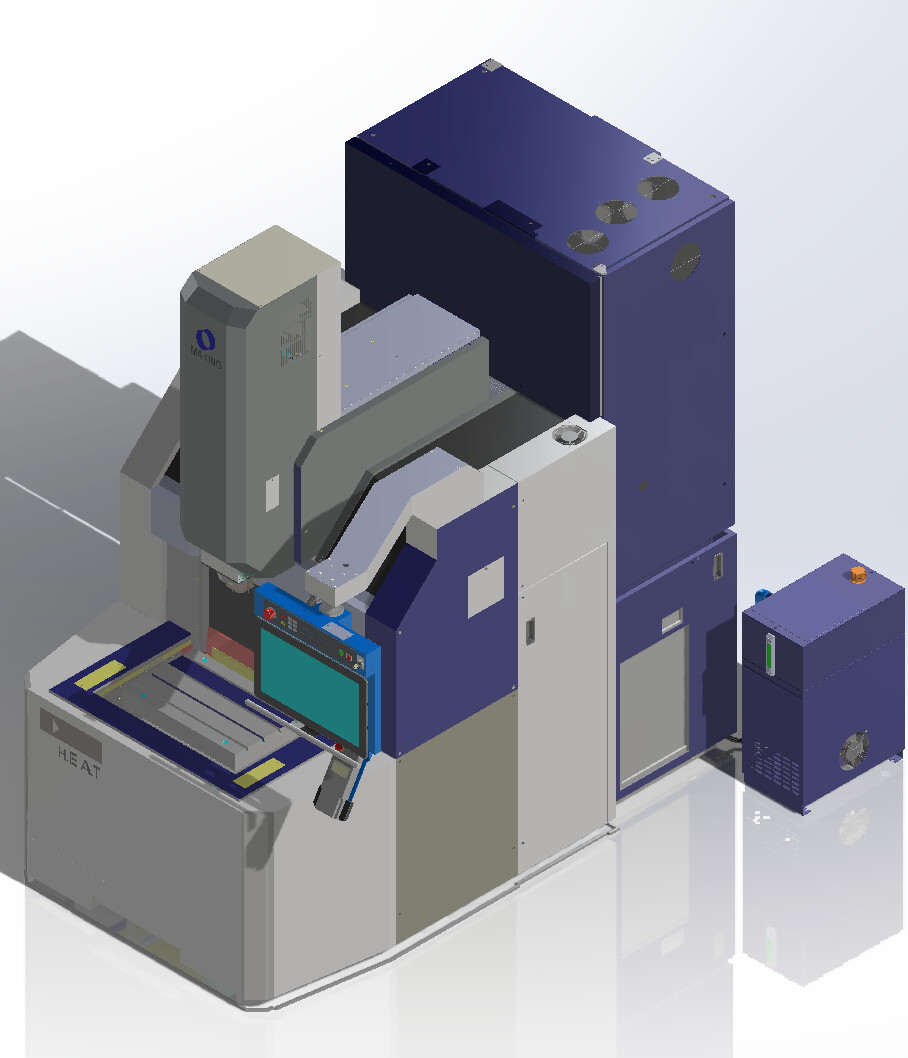

Hi, I am doing a project that involves an Electric Discharge Machine (EDM). A robot arm will put parts that will be processed into the machine and change the electrode in the EDM. There are no EDMs in the eCataloge, if I an to create a custom machine, how would I implement the electrode changing function? The robot arm will remove the electrode in the EDM, place it on a pallet and pick up another electrode to put into the EDM.
