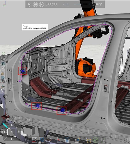

Hello, seniors. I’m trying to use the automatic path generation function of industrial robots. I encountered the problem shown in the following picture: I want to generate a circle of trajectories along the edge of the car door, but there are extra points planned out automatically (as indicated by the red box). I need to delete these extra points, but I don’t know how to do it. Could anyone offer help and teach me how to modify and delete trajectory points in the path action?

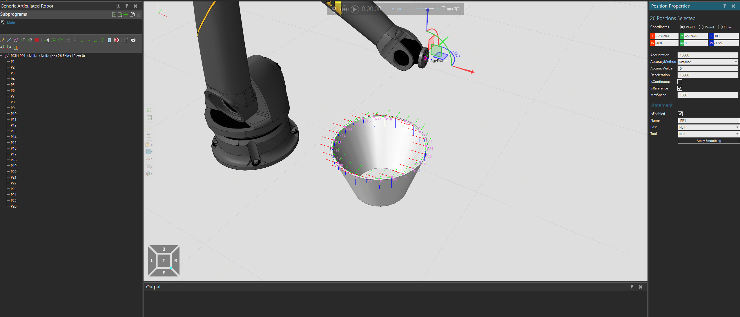

You have to select the points first and tick “IsReference”, if it is already ticked on, tick it off and back on:
Selection happens by holding ctrl + mouse 1 (LMB) or using the “select” tool.
